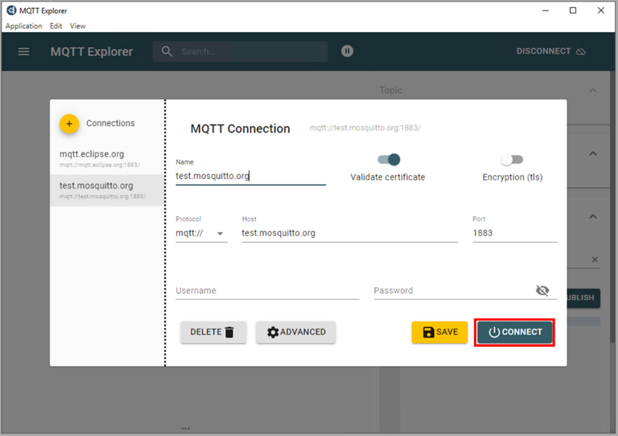

You can download MQTT Explorer client by going to the following link: https://mqtt-explorer.com/.
MQTT Explorer is an MQTT client that can be used to view a structured overview of your MQTT topics. We’ll be using this tool to simulate communication between InTouch and an MQTT broker running locally.

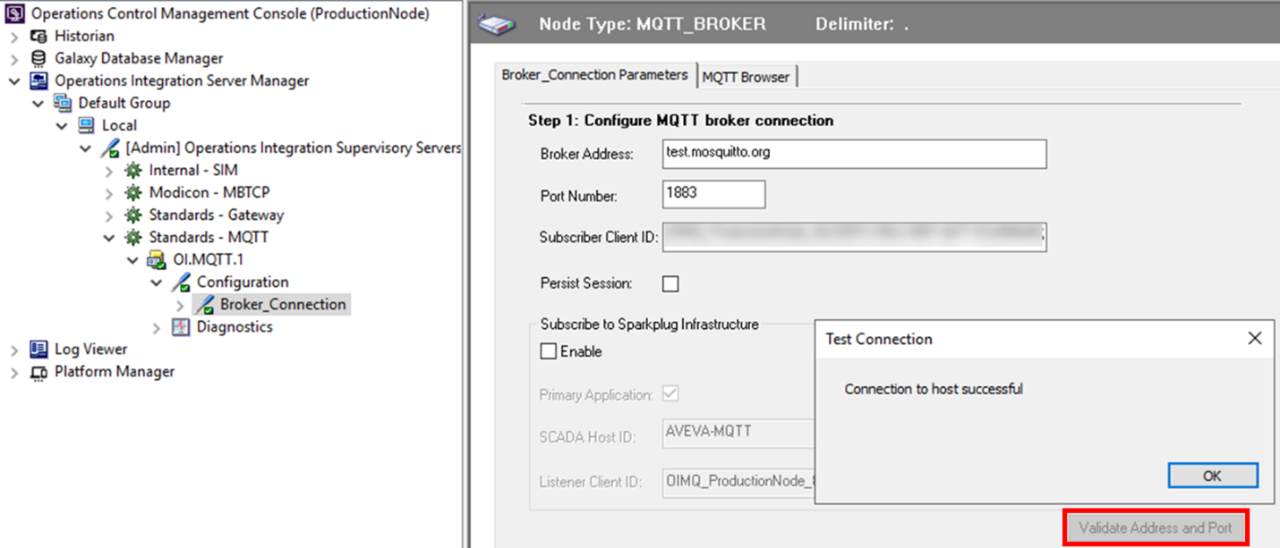

Once everything is installed, the first step is to open the Operations Control Management Console (OCMC). This is where you configure InTouch to connect to your MQTT broker. In the communication driver section, add a new connection and enter the broker address and port. After entering the information, click “Validate” to ensure the broker is reachable. If the connection is successful, you’re ready to start tagging.
Set up the MQTT Communication Driver

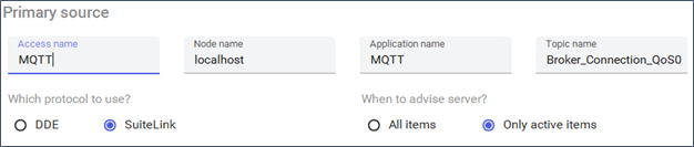

Next, open WindowMaker. In order for InTouch to communicate with MQTT, you need to create an access name in InTouch for your MQTT driver:

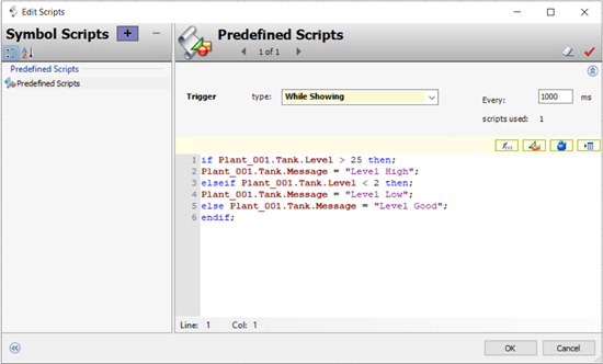

To make the interface more dynamic, add a simple script that updates the message based on tank level. This script will execute whenever the level changes and allows you to simulate logic-based messaging.
symbol scripts

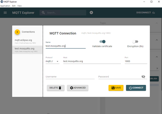

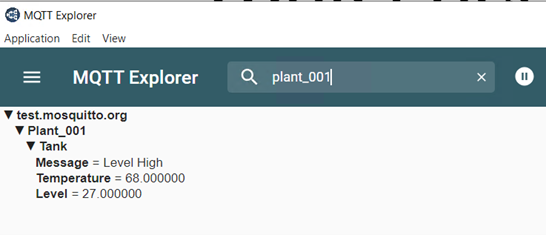

Now it’s time to bring everything to life. Open MQTT Explorer and connect to the same broker.
Open MQTT Explorer
Launch WindowViewer and interact with the faceplate. Manually update the Tank Temperature and Tank Level values — as you do, MQTT messages will be published in real time.
tank faceplate
tank faceplate

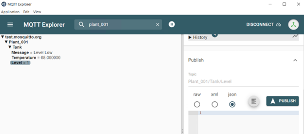

In MQTT explorer, search for “Plant_001,” and you can see the three tags that have been published from InTouch. As values change in InTouch, the corresponding messages update live in MQTT Explorer.
Plant_001
Communication works both ways. In MQTT Explorer, try publishing a value back to InTouch. For example, click the topic Plant_001/Tank/Level, and in the Publish section, publish the value 1. Immediately, you’ll see that change reflected in WindowViewer—and if you wrote your script correctly, the Tank Message field will display a low-level warning.
