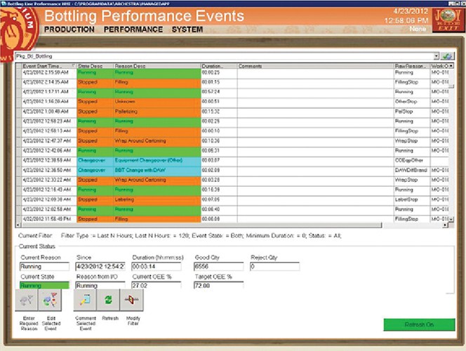

The brewery’s existing systems provided huge amounts of data, but without context. AVEVA Manufacturing Execution System provided a way to effectively collect and analyze that data in order to turn it into actionable information. Now, with greater visibility and a true understanding of actual production capacity for predictable order fulfillment, New Belgium can maintain its production and sales targets. Management is also able to effectively reduce production costs and improve overall product quality at the same time.
“At one point our filler was experiencing a significant amount of micro stops due to some bottles coming down the line that were falling down, or getting hung up on rails,” Herrick said. “The AVEVA software was able to provide us specific information related to these downtimes, so we had our team complete a Kaizan evaluation to figure out what we needed to do to improve it. We decreased our downtime by more than 50%. This is very significant for our business.”

“The ability to customize graphics provided by the MES enabled SkyIO, Inc. to develop a system that could effectively communicate the line status and production capacities in the New Belgium bottling and packaging lines, while at the same time illustrate the company’s unique company culture with engaging graphics,” Vail said. “Screen data shows what order is being worked on, what is coming next, and how the current rate compares to their standard.
