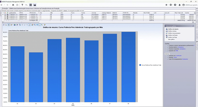

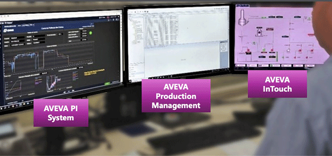

Once the design was mapped out, the team began building an integrated system that would fully leverage CBMM’s existing AVEVA investments—each solution playing a distinct role in defining, executing, and monitoring the power curves. Using AVEVA Production Management, the system defines power curve recipes across refining phases, ensures recipe traceability, and consolidates related production metrics to calculate recipe adherence. Next, with AVEVA PI System, CBMM gathers real-time production data and calculates metrics to track the actual power curve and its alignment with the reference curve. Finally, AVEVA InTouch HMI serves as the PLC interface, managing the download and execution of the power curve recipe.
This dashboard in AVEVA Production Management shows, month by month, how closely furnace runs adhered to the power curve recipe.
Together, these three solutions enable CBMM to standardize and implement power curves while also executing, controlling, monitoring, and automating furnace operations. “Now, our operators don’t need to change the power manually,” says Amanda Branco. “The system does it itself.” By removing the guesswork from furnace operations, the new system not only reduces energy consumption; it also helps minimize safety risks.

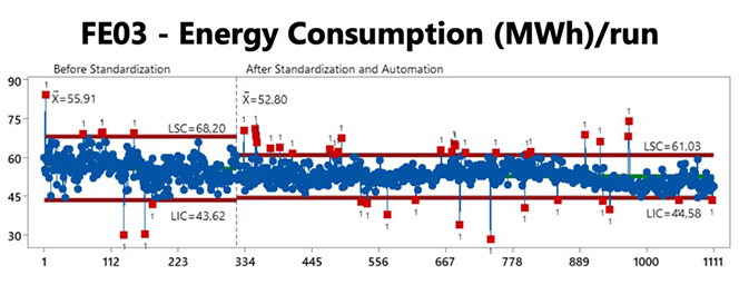

With power curves standardized and automated, CBMM has seen marked improvements in the efficiency of each of its three furnaces, especially the newest furnace, Furnace #3. Before CBMM had implemented and standardized power curves, Furnace #3 used 55.91 MWh per run. Now, after implementation, Furnace #3 consumes 52.80 MWh per run. That’s about a 5.5% reduction in energy consumption.
Furnaces #1 and #2 saw approximately 1MWh reduction per run. The energy savings between all three furnaces totals approximately US$ 140,000 annually.
Aside from improving efficiency and safety, the new system has also reduced cycle times by about 7%. “Just because now, we know what we’re doing,” says Amanda Branco. “We can see when we’re doing much better or when we’re doing worse, and then we get a standard. It has been really great for the process.”
